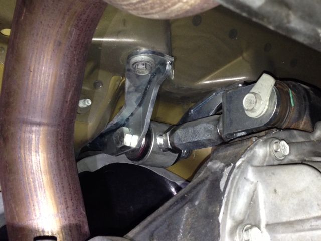

This is why I test the products I sell before I offer them as a product at Revan Racing.

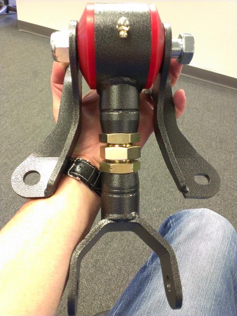

This is a complete and total FAIL by Whiteline. Not to mention you can't get the pinion angle on their adjustable arms past 0.
I was approached by Whiteline to sell their product with BIG margins but for me it's not about making as much as possible! It's about quality!
That is why I sell BMR Fabrication and Grigg's Racing Suspensions Exclusively.
Van
Yikes! What were you doing that caused the failure?
It's from a customer who gave it to another Mustang owner. This is not the result of an accident or anything like that.
holy hell man!! imagine rolling through that double apex lift off for the rotation...and bam!!! game over!!
This would be a really bad thing in a corner.
Man... that sucks.
Looking at the overall thickness of the material it doesn't look impressive. I remember looking at the BMR unit I put in my car and thinking "Dang, thats beefy!!". The one pictured above.... not so much.
Exactly! BMR uses a much denser steel and this picture is a perfect example of cheap crap. It's not made in Australia as advertised either.
It's made in Korea.
Man... that sucks.

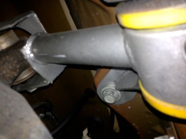

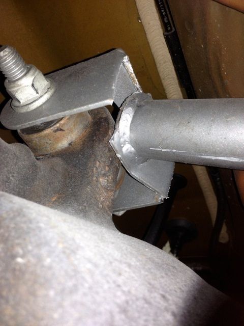

Can't really see if it is a bent box design or welded in all the corners. I do see a lot of cracking and bent box designs are not very strong.
I would look at the material certs and the carbon content and composition of the material. Heat from welding has compromised the strength.
How do I know this you ask.... I've been in manufacturing of automotive components and military associated parts for quite some time. Have seen this problem many times in returned product after durability testing.

Comparing the thickness of our steel to others we need to factor in the grade of materials used. We use 4130 Chromoly steel which is stronger then mild steel. We factored weight/strength compromise, torsional strength integrity, and other characteristics into our decision making.
