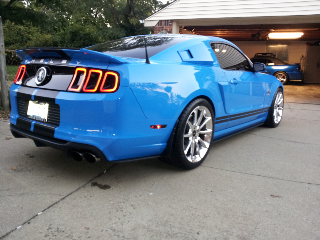

325/30/20 on the rear on mine with Carroll Shelby CS14 Wheels. Sorry not a very good picture.
218213
Great shot to show the fitment of larger rear wheels/tires. If I read correctly, you have CS14 wheels. These should be 11" with 50mm offset. I think that this should be putting the wheel .75" out and .75" in from the stock 9.5.
Maybe there are different specs? I looked at website prior to post to check on the specs. This is the info that I saw listed. Not doubting what you are finding. Just seeing this listed for the 11" CS14 wheel. Could be more than one part number of CS14 11" wheel available for all I know. Either way, it should be a subtle difference. Backspacing between the two are 7.97 as seen here or 8.125 as you have attested to having found.
