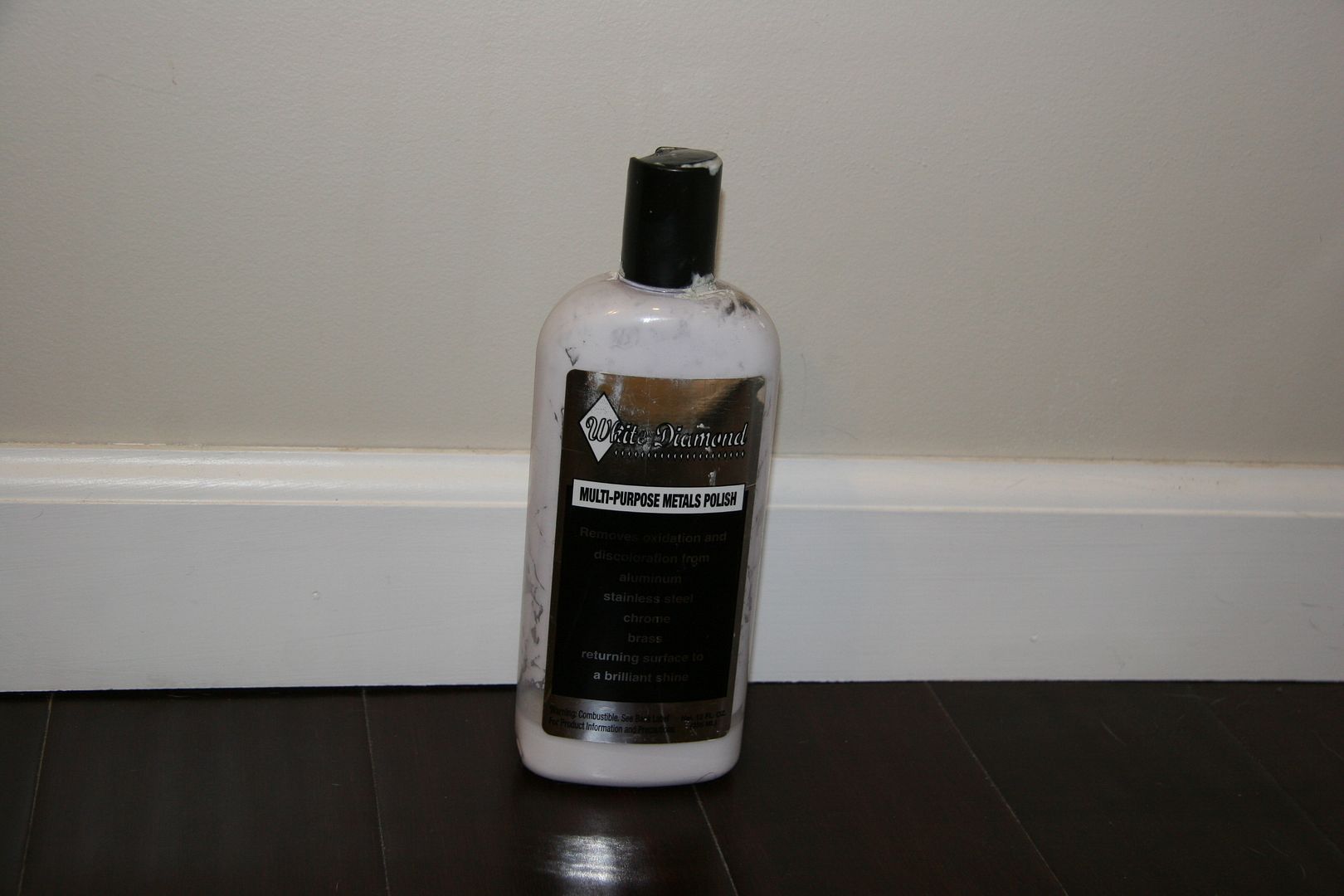

For those looking for a kick ass polish, try White Diamond Multi-Purpose metals polish. You will never go back to Mothers. Less effort, brighter shine and longer lasting. Biker approved.
Since I have a lot of respect for your opinions I'll give it a try. Where can I buy some?
And Goose17 and Hardage, don't forget that elbow grease!!!!!!!!!!
O'Reilly Auto Parts
It works excellent with microfiber cloths and mothers power cone polisher. I mostly just use it with the microfiber cloths. If I get a tuff dull spot, i will break out the mothers power cone and will use the White Diamond polish to bring back the bling.

I got the polish at Advance Auto and I have the mothers power cone polisher but I didn't have a lot of luck previously using that cone or the ball trying to polish the Whipple. The ball and cone just seem too big to get into the nooks and crannies in SPITE of what Mothers says. But I guess I can try them again if need be with the White Diamond. Gosh this stuff looks thin but as I said I'll give it a try. I'll also check my bits for the dremmel and see if I have anything that looks like it would work.
I'll give it a whirl! (I've always used Mothers and asssumed they were all equal.)

Well I finally figured it out or put it all together. I don't have the White Diamond Mufti-purpose stuff but did get the White Diamond Metal Polish and Sealant. And I finally got the Dremel 422 polishing bit and that sure did the job. That polishing bit is small enough to get into all the nooks and crannies. I think what I still need though is several additional 422 polishing bits so I have one to polish and one to rub out the polish. So need to go buy an additional bit.
Goose17 warned me about polishing, saying be careful as the polish could go everywhere and with the Dremel and the thin White Diamond polish he is right. I have polish on my shirt, jacket, and on many parts of the car. It was a mess until I got some detail spray and cleaned it off the car but the Whipple looks the best it has looked since it was installed, at least it does on the one side I polished. I need still to do the other side. And it is a little time consuming. I find often in the nooks and crannies I need to polish it two or three times as it is easy to miss spots. And I'm running the Dremel on the slowest speed so I won't burn through like the Whipple guy said you could.
