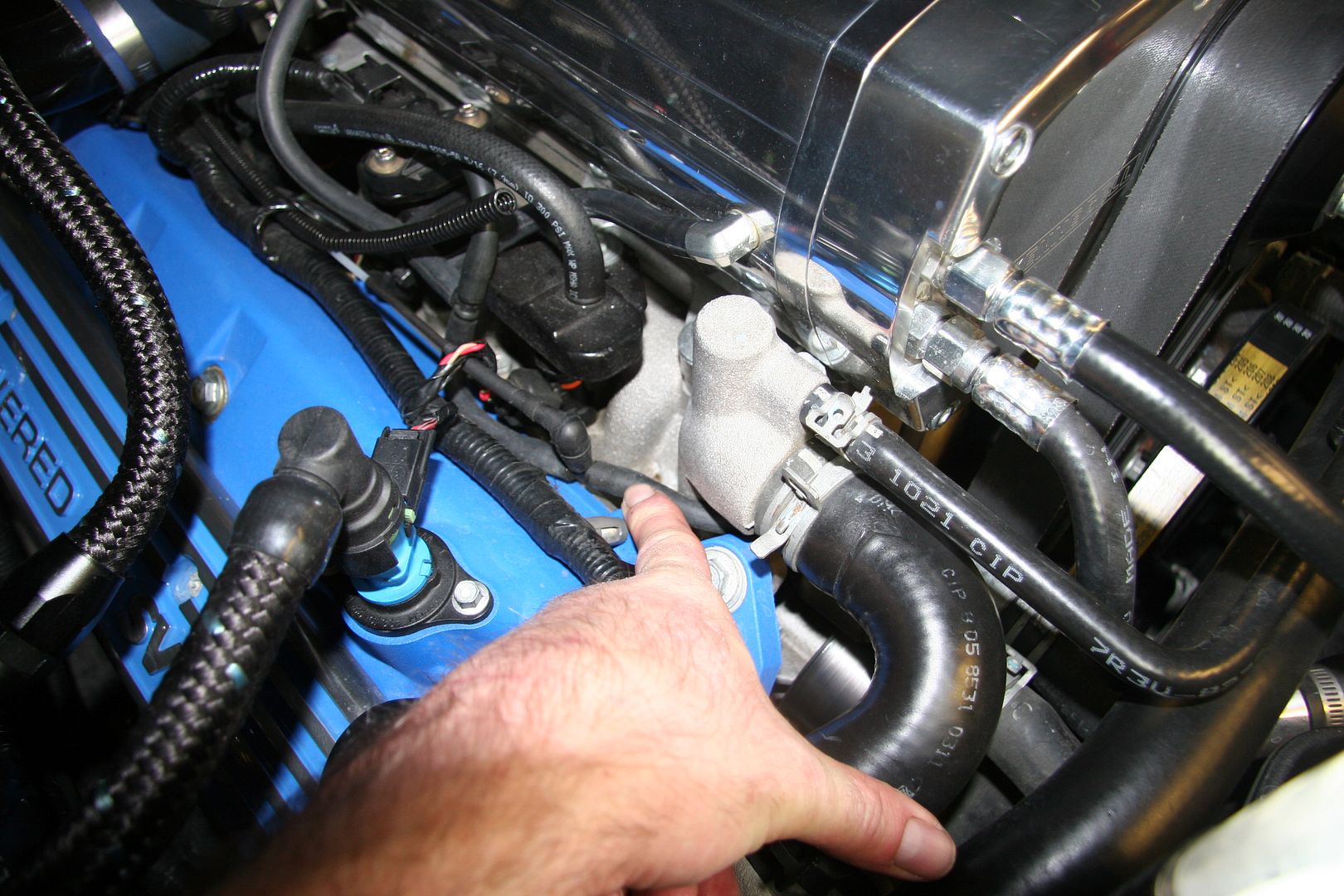

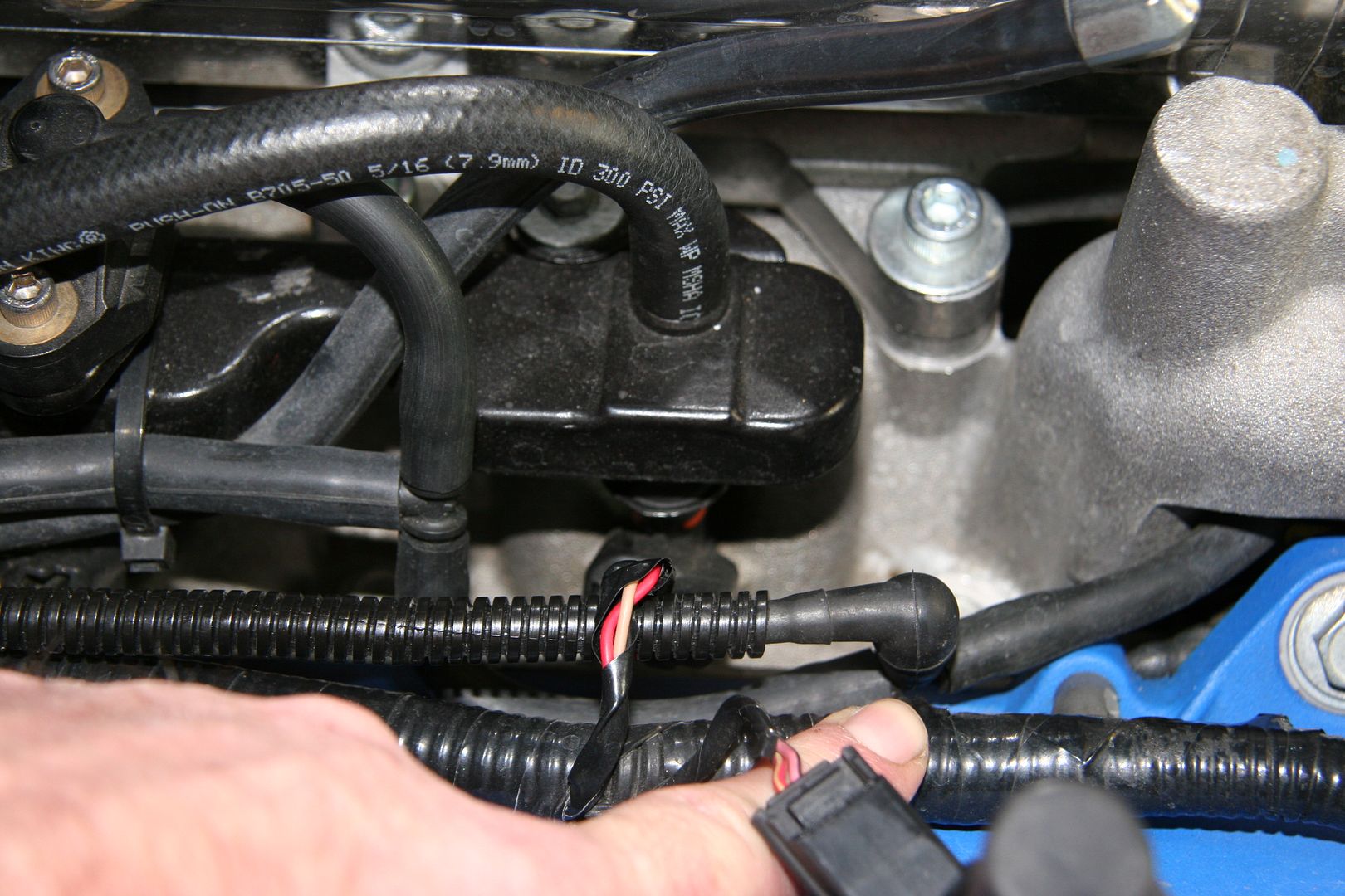

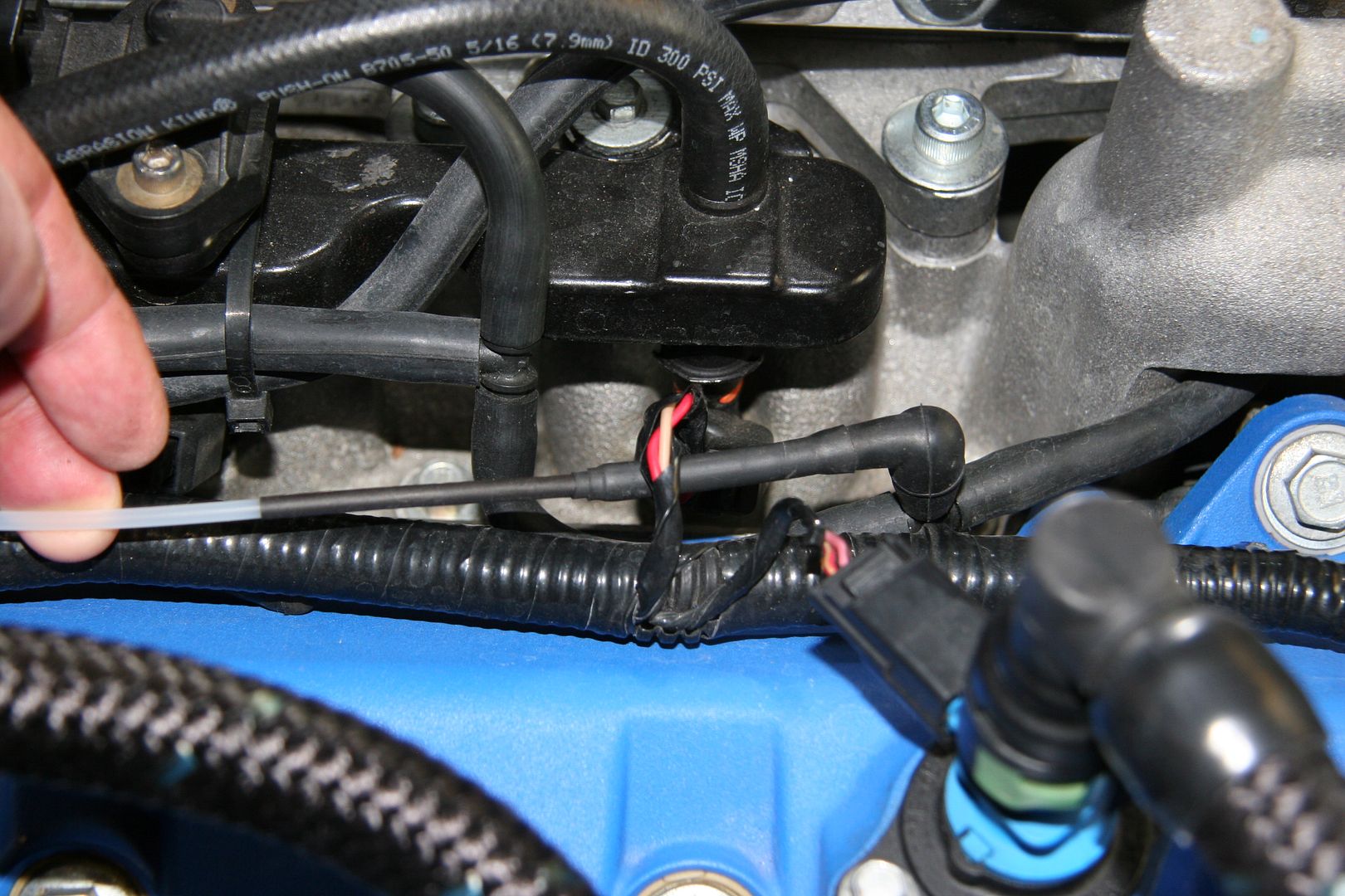

Here's how i did mine. I used a T fitting and then used the factory 90 degree fitting off the Eaton Superchargers bypass valve. I cut the black plastic hose coming out of the 90 degree elbow since it is barbed and holds the hose securely under boost. then I used a small diameter vacuum hose to connect the two plastic hoses. I put heat shrink on the end of the white plastic gauge hose and applied heat to shrink so it would stay secured in the vacuum hose. Slid it all together and heat shrinked the outside as well.

My measuring caliper is at work. Looks to be 1/4 inch to me. I just purchased a black plastic T from O'reilly Auto Parts Store. You could pick up a 1/4 to 1/16 T and do the same with the heat shrink if you don't have the 90 degree oem fitting. The main reason I used the oem 90 degree fitting was for cosmetic appearance.
Hardage is correct. This is the vacuum hose coming from the front of the intake and going to the fuel pressure regulator. I tapped into it where I did because I already had a Vacuum T at the regulator to feed the KB bypass Valve.
If you do it like Kurtdog, you'll have to go buy more hose too. Stock, the hose coming from the front of the intake and going to the fuel pressure sensor is just a small plastic tube similar to the tubing provided with the boost gauge and the stock line that goes to the supercharger bypass valve (which Kurtdog removed and used the 90* elbow for boost gauge install). I know this for certain as I just swapped mine out 2 weeks ago. I swapped it out because I T'd off of that line to go to my Kenne Bell bypass valve.
