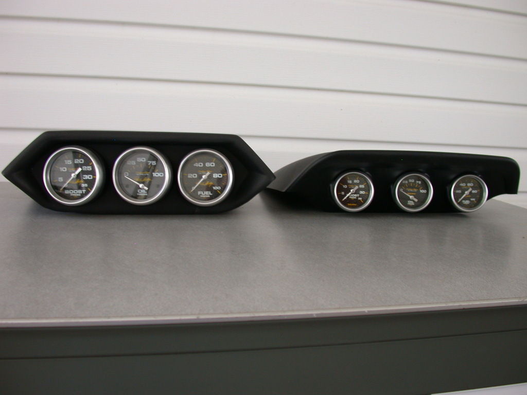

I also played with the Auto Meter brand dash pod for the 2005-2009 Mustang and the smaller 2-1/16" Shelby CF gauges for a lower profile look. The Auto Meter pod has the "angle" built into it. Shown below are the regular Auto Meter gauges from the CF Series (not CS signature), those gauges have since been sold and replaced with correct CS/CF 2010-2014 Super Snake gauges.......side-by-side.....
