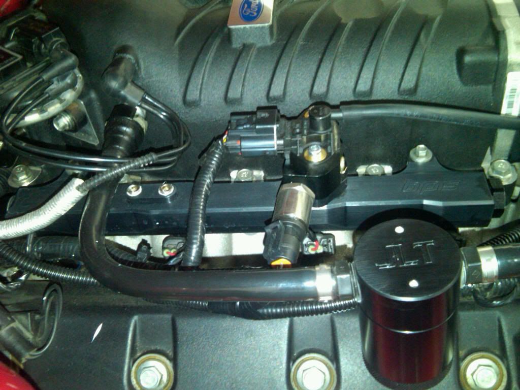

Was happening on mine also,decided to change the fuel rails and upgraded to BPS Billet Rails along with hose kit to go around rather than over the top. The look is much cleaner.

See my BPS rails also.Cool. The look is def cleaner. Any pic of yours? You get black or polished?
http://www.fordgt500.com/forums/showthread.php?t=30514&highlight=upgraded+JLT+heat+shield

I have black ones. I have an engine bay shot but they are tough to spot.
I will try to get a good shot later today. My car is in the shop getting a new EGR valve put on.

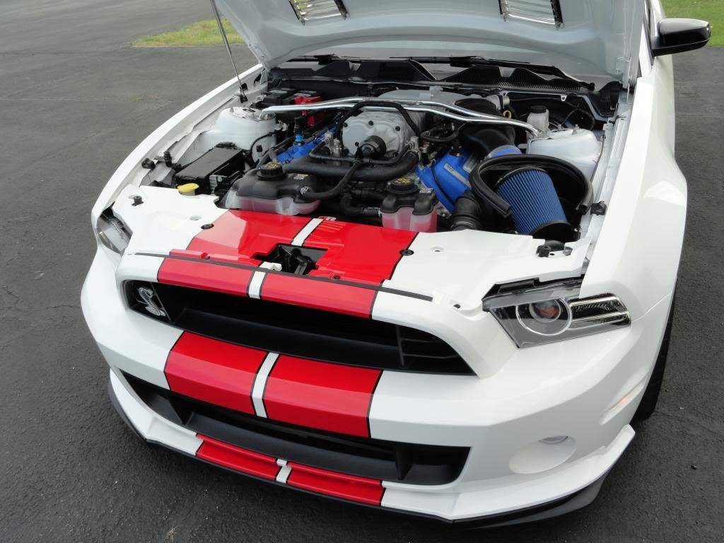

#10 · (Edited)
I had my brace chrome plated. I dont have a close pic, but you can see the fuel line sticking out like a sore thumb! I looked @ your link, those BPS rails look clean. Iv'e got the aluminum tanks on order, they would match the rails perfect! Approx how much are the rails?
