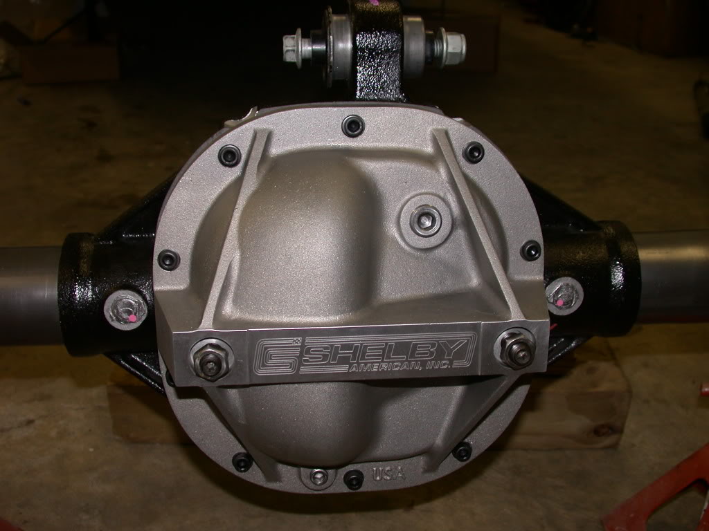

For those who want a Cool Looking/Unique 8.8 differential cover for your Shelby, the Shelby 8.8 girdle/cover in now in the Shelby Perf. Parts Store Outlet.
If you compare prices on these girdle/covers for the 8.8 Mustang, this is a Great deal and it is SHELBY engraved!!
^^^^This cover will require a panhard bar relocation, just like the FRPP G1 girdle/cover.
Below with panhard relocation bracket shown.......
It is a Very Cool looking piece!!
Just thought I would mention it because we were discussing diff. covers over on SVT Perf. and at $130, these Shelby girdles will probably be gone fairly soon.

It def. will not fit with watts link, there is a mention of that in the Shelby description........
Requires a panhard relocation bracket.
Will not fit with Shelby or Fays2 Watts link or Mustangs equipped with Track Packs.

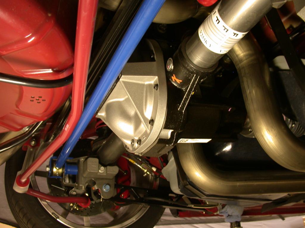

The one I have is installed on my cars 8.8 as shown in the picture above.

Did this fit with your original setup from SAI? I think our cars have the exact same suspension setup.

Yes, the original Eibach Pro Street-S coil overs and the Blue Granatelli panhard bar. The only difference on my car now, that is not shown in the underside view is that I have installed BMR LCA relocation brackets and removed the harmonic weights, but that did not affect the fit of the cover or panhard bar and relocation bracket.
Since Shelby installed the Granatelli panhard bar on the earlier Super Snakes, that is why I used the Granatelli relocation bracket.........I'm sure Carroll Shelby and Andy Granatelli had been friends for decades, so I figured I'd - "Keep it all in the family"............:giggle:
