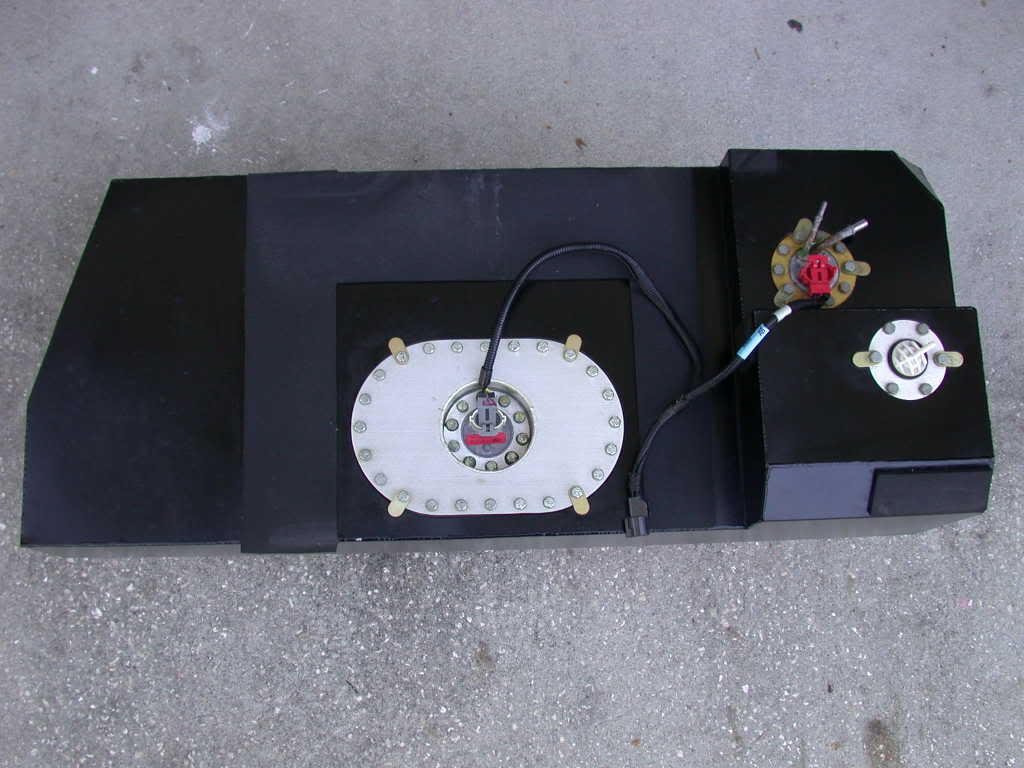

Not to get too far off-track but here is what the 1995 Cobra R Fuel Safe cell looks like...........This was after the old/leaking bladder had been removed and replaced and the cell was ready for reinstall.........
Note the multiple connections to both fit in the oem fill and vent locations and other connections to keep the oem street fuel system happy......Definitely not a universal Fuel Safe fuel cell for a race car application.......
^^^That label (and its date) is what the track inspector would be looking for to allow the car on the track in a sanctioned SCCA, IMSA, NHRA or IHRA event. If the date is past due, the track inspector would want to see a current up to date certificate that comes with the new Fuel Safe bladder.....

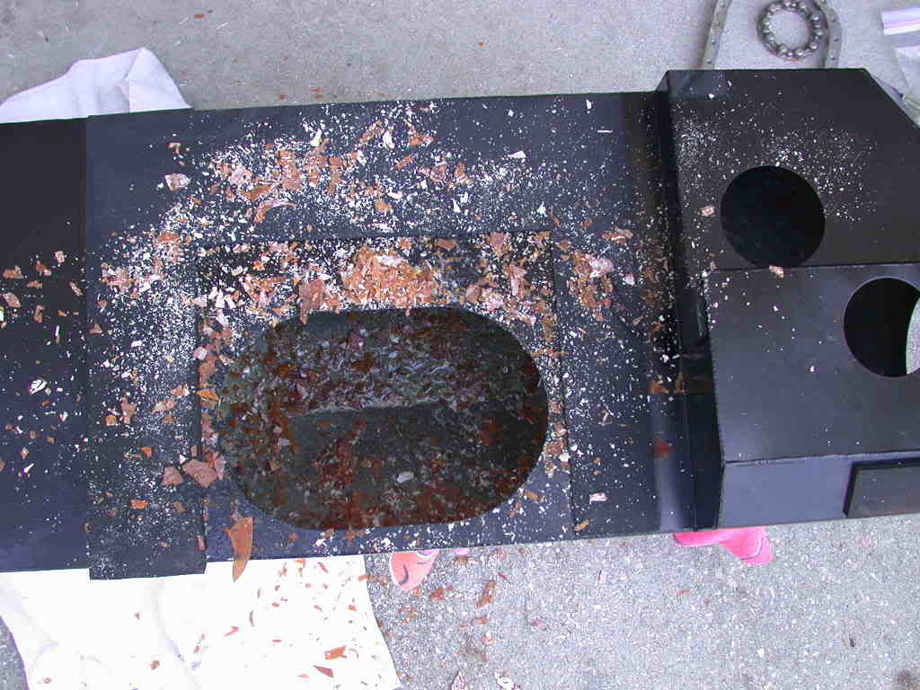

................and then the "Ugly"............the original bladder outer liner was in pieces.........
................and of course raw fuel damages everything it comes in contact with, the rubber/foam insulator pads that hold the cell in place........Those straps are Fuel Safe items, not Ford......
.............and the anti-slosh foam that form fits inside the bladder so that the weight of the fuel does not sway the car side-to-side in hard turns......
And it all started with "The Dreaded Drip"...............
