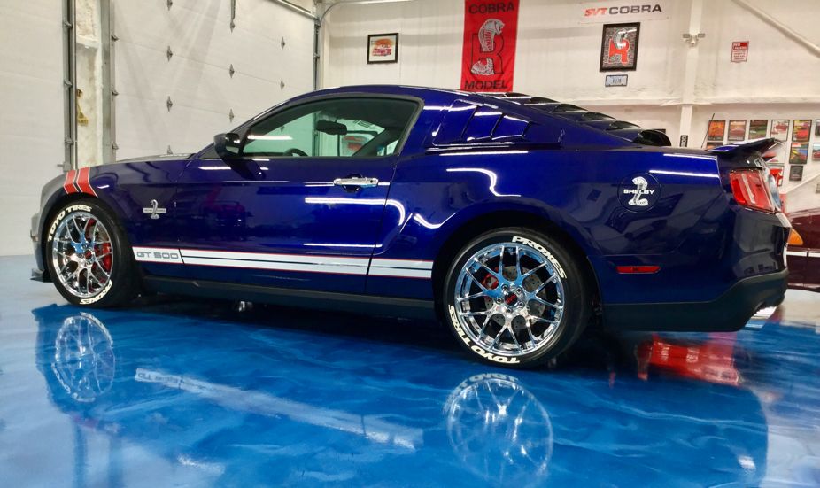

So cars at the shop right now getting some upgrades and it looks like the rear diff might of took a crap so trying to weigh in my options. It's going to be close to 700whp when finished and more of a street car so not looking for a drag only set up. I've looked into Auburn Pro as a possible solution but wanted to get some opinions first. She has the SVTPP package so she's got the 3.73's. Thanks in advance for any insight.

I'm running the Strange Strac 8.8. Downside to that is you need to run their 35 spline axles and either weld on 9" ends (only Moser sells them) or use Strange's c-clip eliminator kit. I use the c-clip elims and have never had a leakage issue, but I know some others on here have. Anyways, the 8.8 Strac is a really nice diff and holds a lot of power.

What do you think caused your failure?

To be honest I'm not sure, I left for Iraq and left it at a friends house in CA and my parents were coming to pick it up and drive it back to TX, they got to AZ and my dad said he was feeling something not right and took it to discount tire to put it up on the rack and it looked like maybe someone hit a pothole or something because looked like the tire, rim hit the inside hard, and he couldn't move both rear wheels freely so he had the car shipped to TX and the shop that was going to do the work on upgrades, they said it seemed to have a lot of backlash on the piņon gear set up and is going to do more digging but things it's the diff....so I'm just waiting to see what the final deal is. I have already bought wilwood brake upgrade so the rear axles have to come out for that so was thinking might as well upgrade since I'll save money on the labor but still not sure what set up to go...he suggested the auburn pro...
